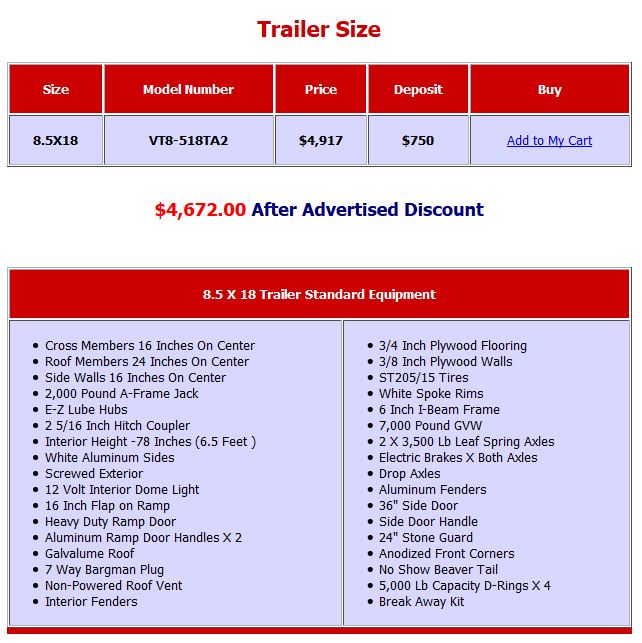

    Kerry, this old post has some good information regarding enclosed trailers.
    I have a Stealth 8.5'x18' box with 2' V nose. Have been very happy with the quality of the trailer but it is more expensive than some of the others. I also added a few additional options like an extended tongue (recommend) and mag wheels. I especially liked the look of the standard screwless exterior although that may not be important to most?

    Thanks, Mike...I had reviewed this thread and others but trailer selection is still a matter of options vs price and I am still debating between a standard 7' wide vs 8' or 8.5' with interior wheel wells, a driver side entry door, and an interior higher than the more common 6"3".
    Do you find the 8.5' width an issue with visibility to the rear when towing?
    Is it wide enough to require extended mirrors?

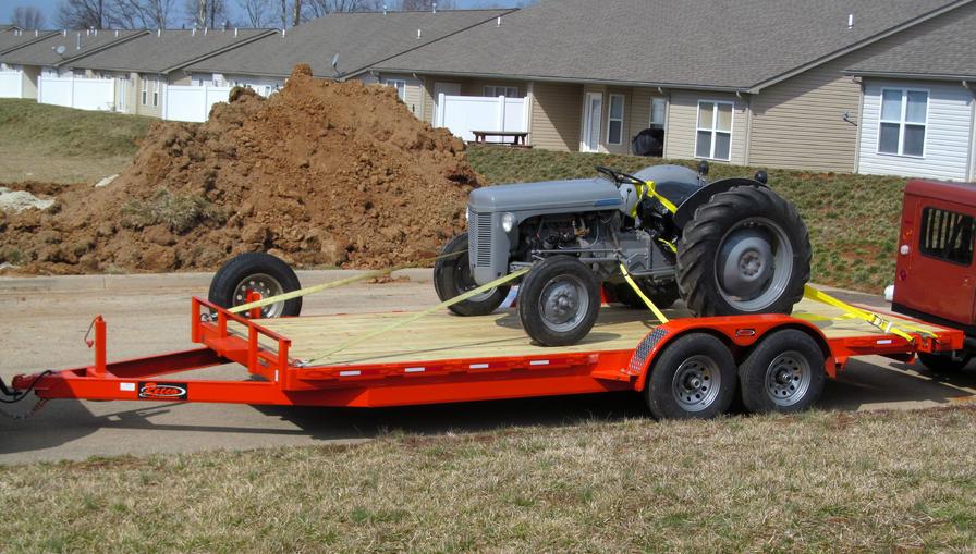

    The extended tongue is a good idea that I applied to our custom built 12,000 lb 20' flat trailer for towing our heavy equipment.
    How much of a premium in cost was the 8.5' width over a more common 7'...?
    What is your interior height?
    Thanks.
