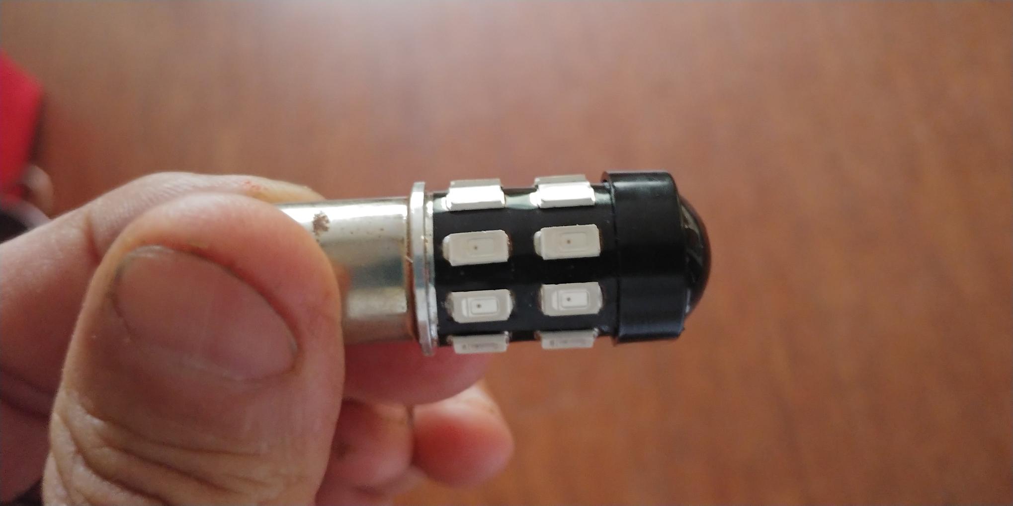

    Ian, I was going to ask you if you changed them. You're upper lights are brighter, but your lower lights are dimmer and have a different pattern. Are the lens different? The lower lights looked like 6 or eight individual lights in a circular pattern. I'm assuming you are running LED bulbs, are they the same bulbs upper & lower?

    Good question...yes the lower bulbs are LED, TOP ARE NORMAL CLEAR BULBS....need to change out bottom bulbs and trash the LED crap...make everything clear... thanks for observations...

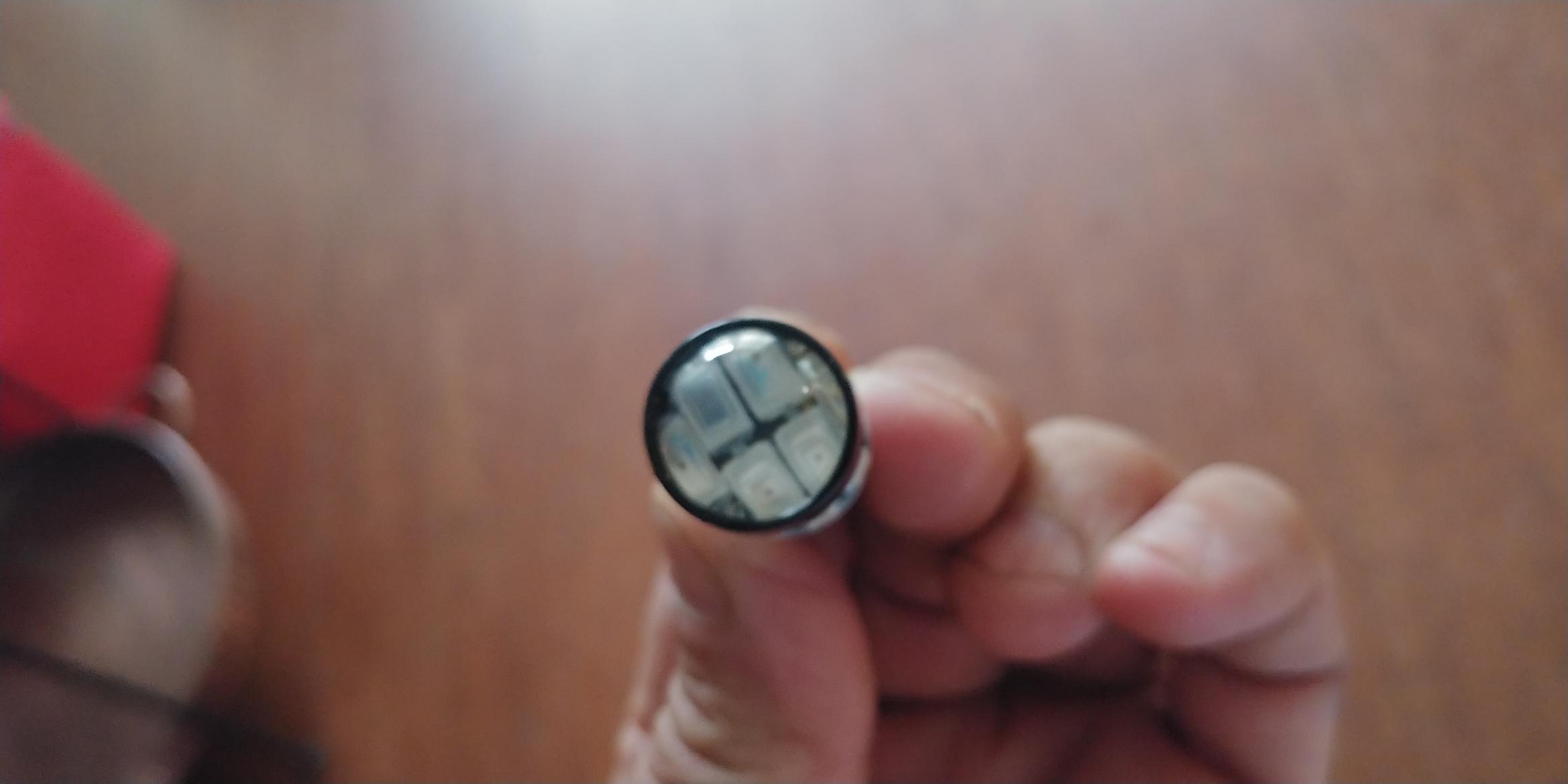

    Ian I noticed the same as Mark with your blinker lights being very dim. Do you know if its Red LED's under the red lens? That could be the problem. With a red lens you would want to put in clear LED's. Normally LED's should be brighter.

    Tony, I was told you should run Red LEDs with Red Lens.
